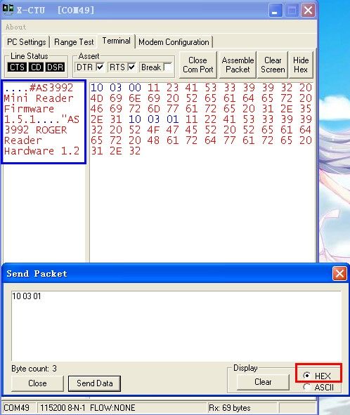

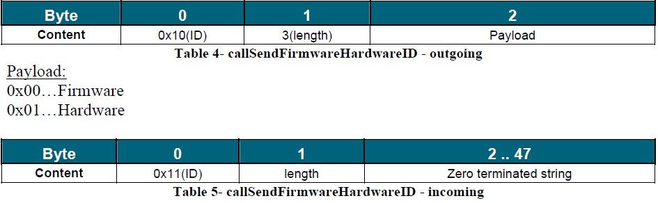

1.1 callSendFirmwareHardwareID
This report sends the firmware or the hardware ID to the host computer.
You can see,
The firmware ID: #AS3992 Mini Reader Firmware 1.5.1
The hardware ID: "AS3992 ROGER Reader Hardware 1.2

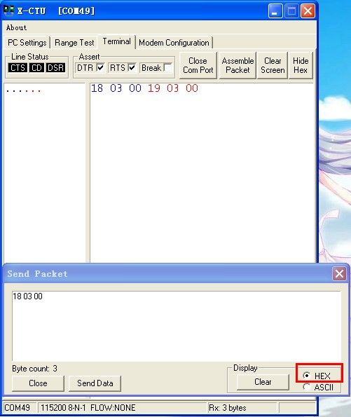

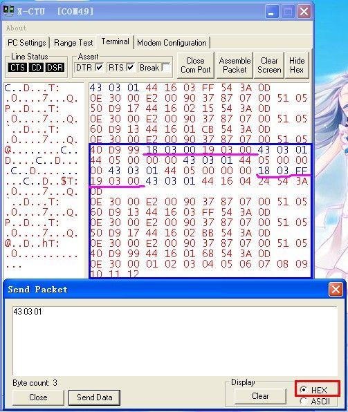

1.2 callAntennaPower
This report enables or disables the RF power on the RF-output ports.
Payload:
0x00------RF-Power OFF
0xFF------RF-Power ON
When disables the RF power on the RF-output ports, the reader will can not communicate with the tags. We will read nothing from the tag.
On the contrary, when the RF power on the RF-output ports is enabled, the reader can communicate with the tags.
